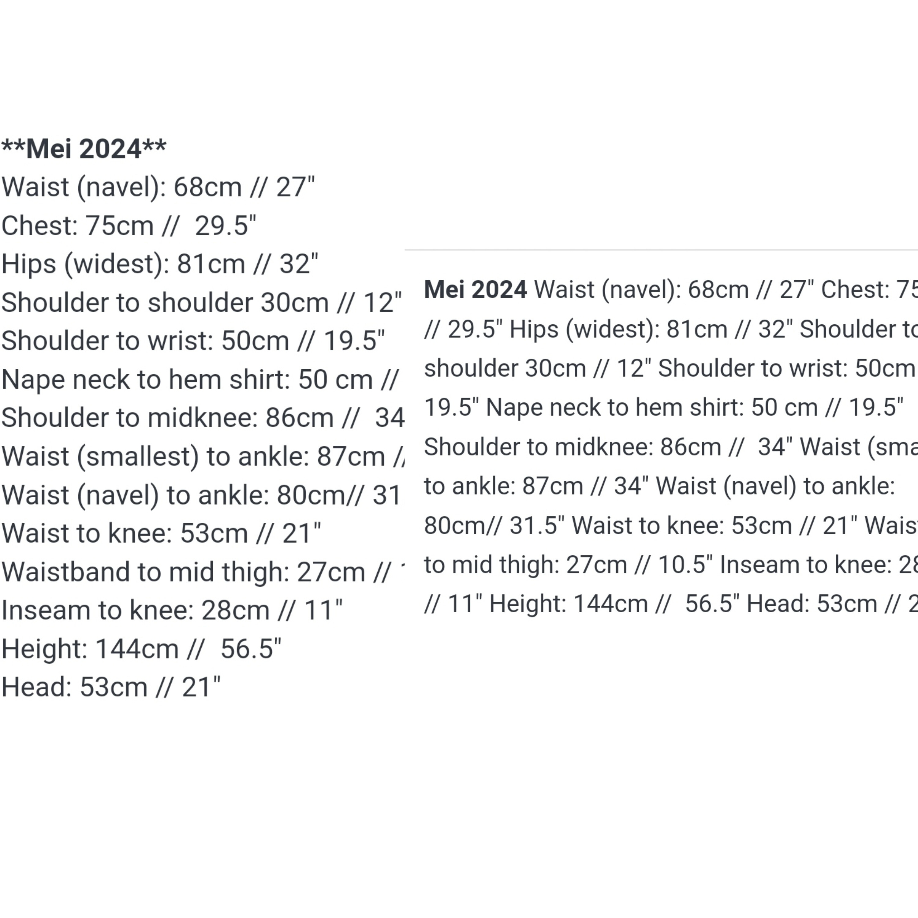

I've been using Joplin for a while and suddenly my text appears differently in all my notes. Everywhere I have used an 'enter' to go to the next line, it suddenly shows everything in a row. So for example: if I've made a list that looks like this
Bread
Milk
Sugar
Tea
Suddenly the note will show
Bread Milk Sugar Tea
It just puts everything on a long line. But when I go to edit the note, it shows as
Bread
Milk
Sugar
Tea
And then when I leave the editing it shows wrong again.
This never happened before and I don't know what to do. It makes things unreadable and I really like my lists so a lot of my notes are like this now.
I added a screenshot with on the left the note in edit mode, and on the right the screenshot shows the same note in read mode. (I was not allowed to add two screenshots so had to get a bit creative here).
I hope somebody can help me out!
This might be related to the "soft breaks" setting in Configuration > Markdown > Enable soft breaks. See also soft breaks in the commonmark spec.
Yes thank you that solved it! I'm very happy now haha
