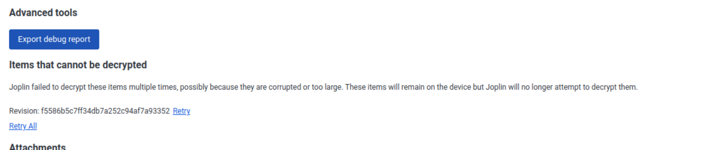

Unfortunately, it happens again or maybe I did not fix it yesterday. Today there is not any note that shows not decrypted as it shown yesterday, How can I identify which note has this problem using ID # f5586b5c7ff34db7a252c94af7a93352. I have checked the last note updating/creating last day and no ones has this ID? How can I identify the issue?
It's possible that a previous version of a note, a notebook, or an image/pdf/other resource (and not a note itself) is failing to decrypt. I think a previous version of a note would be labeled as a "revision" in the decryption error list.
Note that I'm currently working on a pull request that will show more information on the "items with disabled decryption" screen, so hopefully debugging such issues will get easier soon!

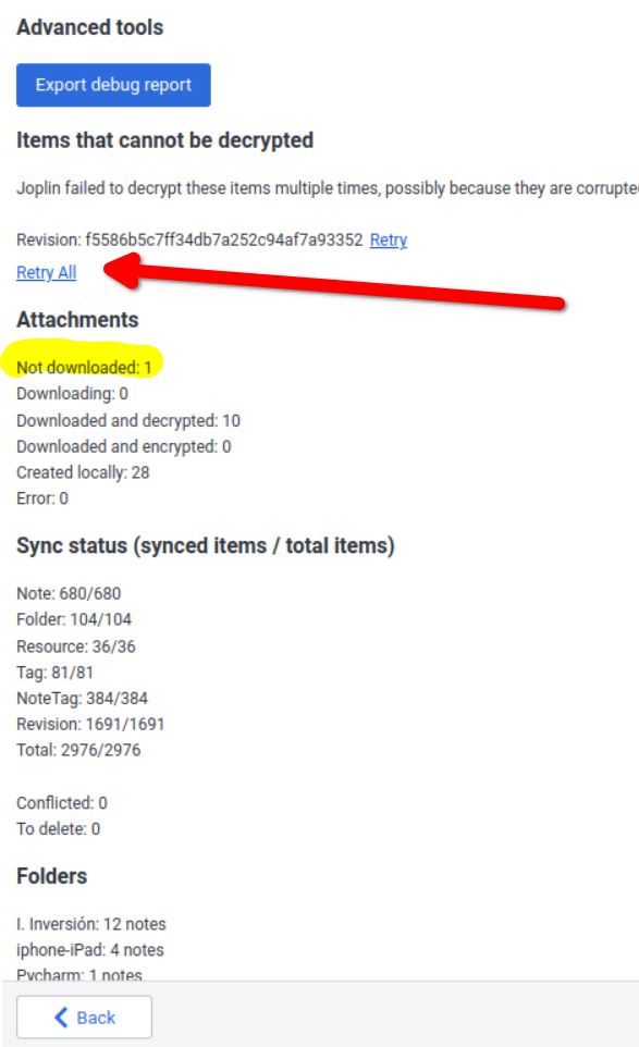

But today, when I saw the warning again with the same item number "Revision: f5586b5c7ff34db7a252c94af7a93352" without any note labelled as encrypted,
I got confused and after clicking the “Retry All” link the warning disappeared until a second or fourth synchronization, then the warning came up again.

As I saw within the advance tool
Only one attachment did not download, so I run rxliuli's web base utility to check for a failed resource and unused resources and, all are fine.
