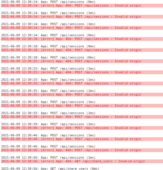

New Install - Invalid origin error
I have tried it with Joplin Server 1.75 and the beta 2.05 but i get the same result
when i attempt to login i get
no matter what i try its the same result
I am using a postgres db
Any help would be appreciated
All tests were fresh installs, no residual data.
Using docker
