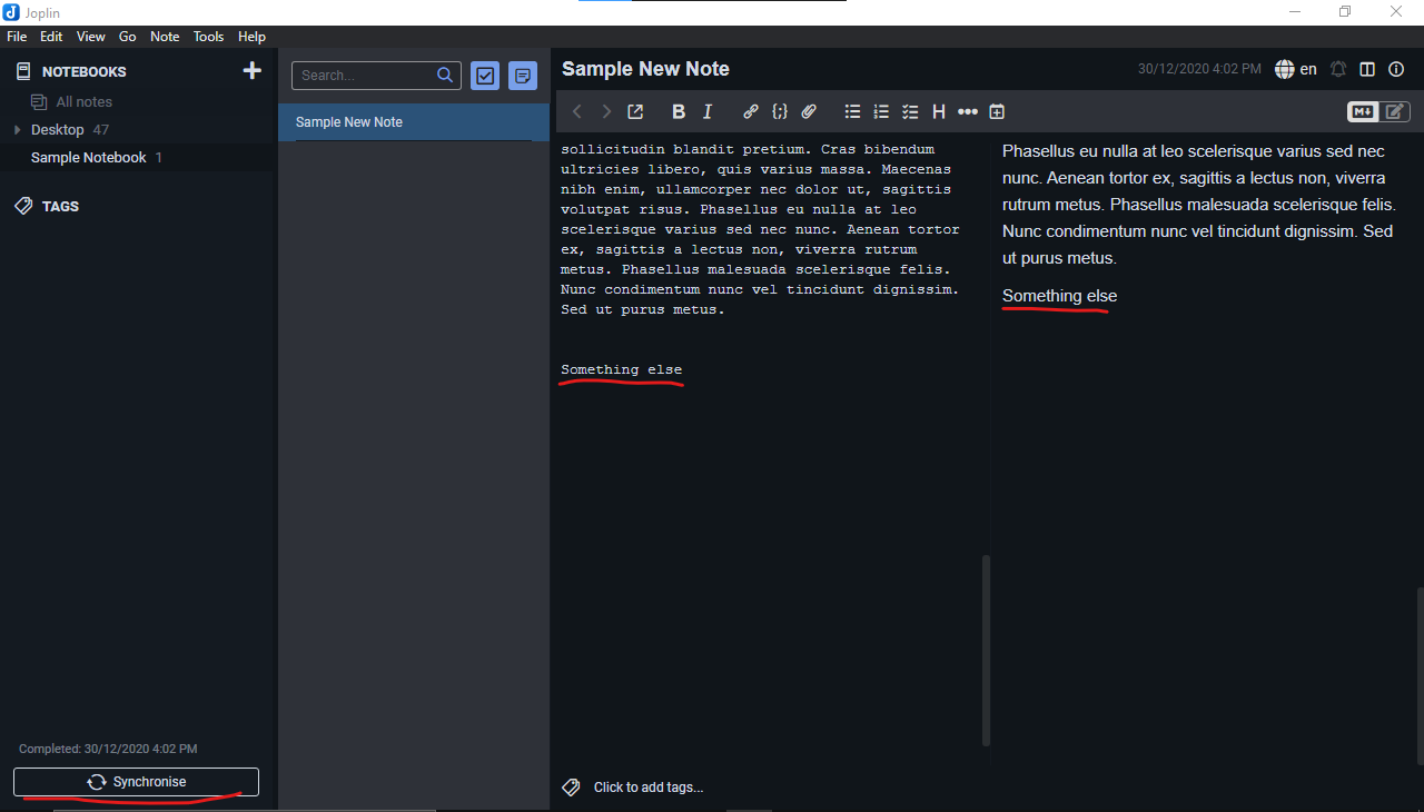

Go to the app (desktop) , press sync and look at the bottom left.
Now go and type something in a note and go back and check that same log area.
Sync button:
Changed a note, didnt press sync button:
Edit - I'm assuming you actually have a sync target here... Otherwise if you are just using it locally then it just saves, ctrl + s just performs a manual sync, not a save.

What I'm getting at is the sync interval you see there is only for 'pulling' i.e. syncing your client with stuff changed on the sync target where the client you are editing in should be syncing almost instantly after any changes - i.e. 'pushing' the changes to the sync target

Press ctrl+s to do a manual sync.
Type something into a note and just wait for 30s
The little log in the bottom left should hopefully indicate it synced - i.e. "Updated remoted items:1", well before the 5m "full" sync.
Does yours not do that?
Yes, it is showing that now.
Does that solve the issue for you then? It won't sync "every second" (although it will save locally instantly) but it certainly syncs far more often than every 5 mins. If you are in some kind of extreme hurry you can always hit ctrl+s to do a manual sync but I don't think I've come across an example where the default sync time wasn't fast enough, it is rare that I would 1) close Joplin fully (if at all) which would possibly prevent a sync or 2) require a note to be synced faster than 30s because I want to access it on another client instantly after typing it
