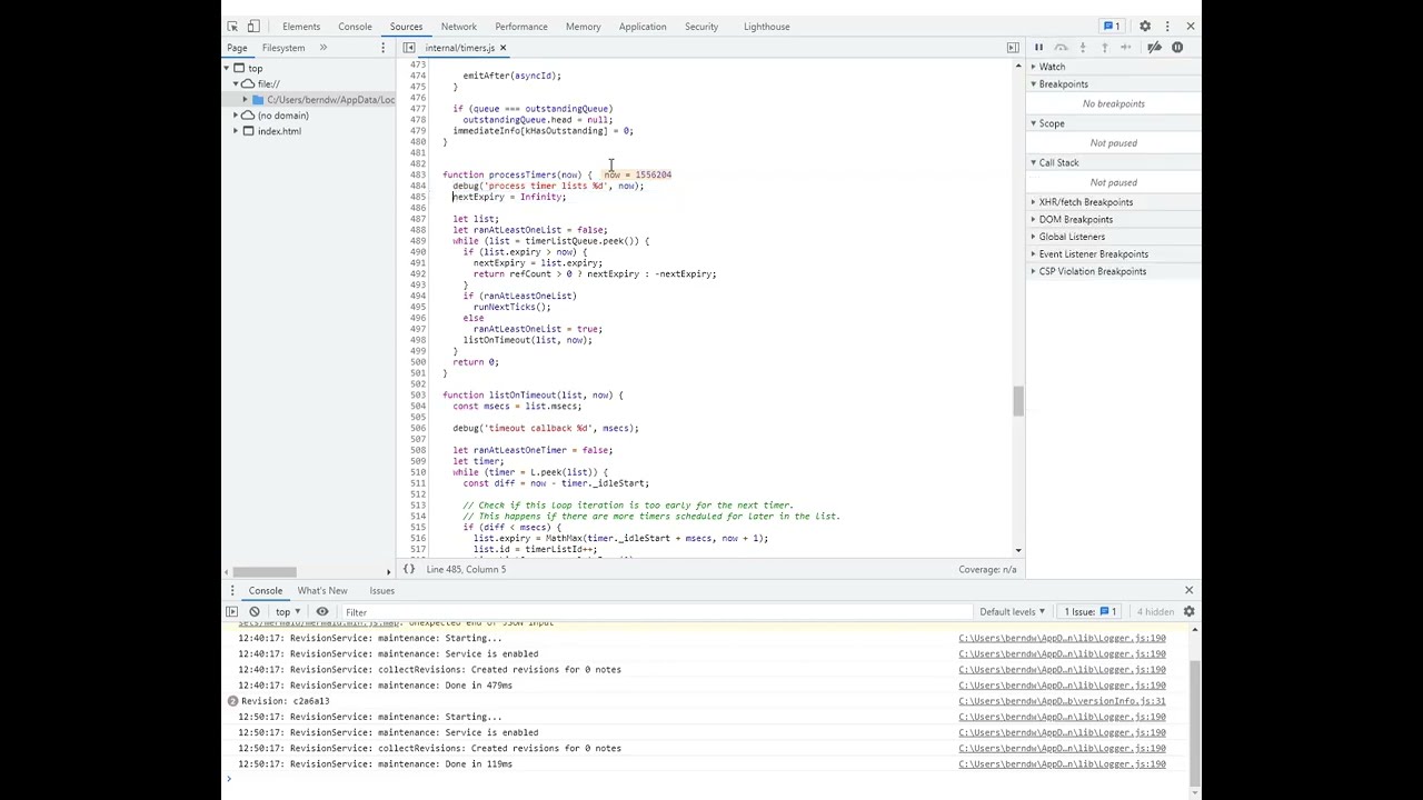

So in the debugger I pause execution while the Cancelling message whirs and it stops here:
I can break any time and always land there reliably, I can single step from there too and always come back to there after 14 steps.
(alas the video ends suddenly on return - wish youtube made it easy to leave the last frame visible).
