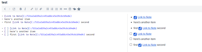

I'm not sure since when this has been happening, but it is certainly not normal. Please see the following markdown and how it is rendered:
- [Link to Note](:/531a2a839a2c493a88c45e39c6cb9ed4)
- here's another item
- first [Link to Note](:/531a2a839a2c493a88c45e39c6cb9ed4) second
- [ ] [Link to Note](:/531a2a839a2c493a88c45e39c6cb9ed4)
- [ ] here's another item
- [ ] first [Link to Note](:/531a2a839a2c493a88c45e39c6cb9ed4) second
This is strange. I can't find anything in the code that would make a difference depending on the OS. In my case the link seems to have line breaks.
I've just noticed that the image is cut off and that this might give the wrong impression, because it looks like the text is wrapping. Thus here my image again:
