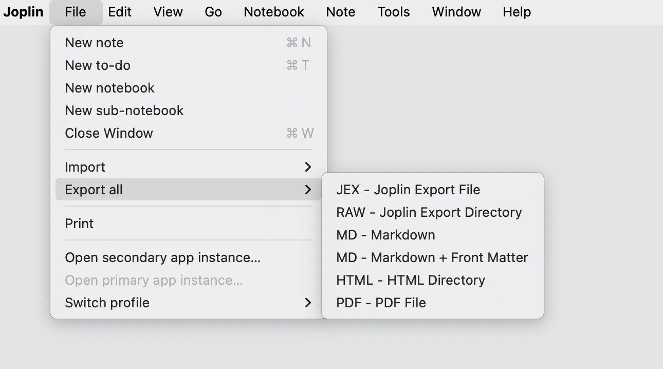

I cannot print the note. When I press “File” -> “Print”, nothing happens at all

I cannot print the note. When I press “File” -> “Print”, nothing happens at all. Please help. Thank you.
Export as *.pdf does also not work:
No file there.

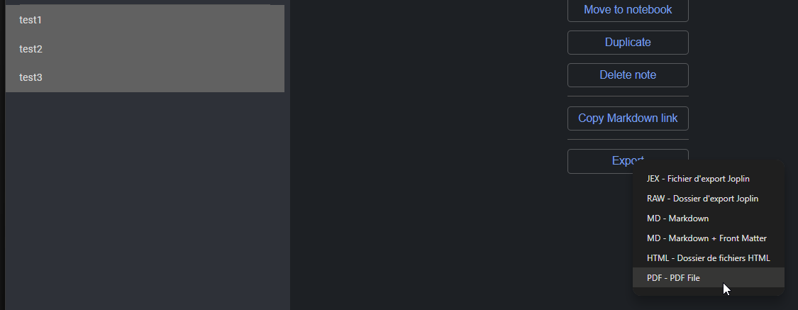

Sometimes it's about delay:
