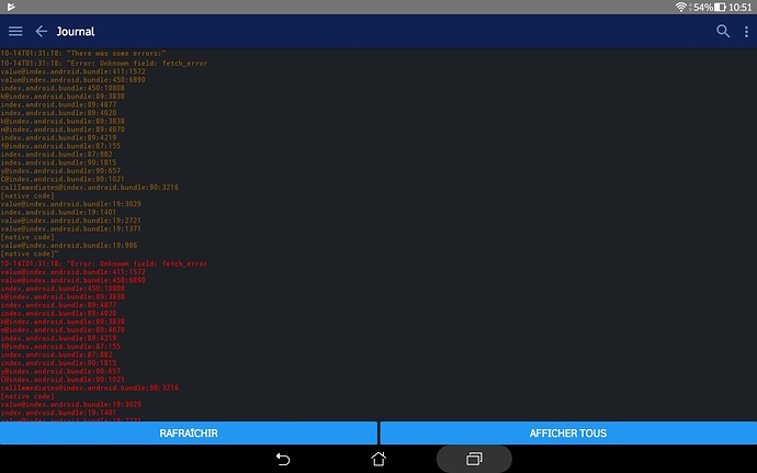

ok so, as I said earlier, it does not crashed at all for me (on Android 8), but I got “unknown field” error message
But as I was stucked I wiped my joplin installation and so now it’s syncing since then.
with version 174, i'm still stuck with my previous error :confused:

That’s annoying, it could mean that the db didn’t upgrade properly. Does it work if you downgrade for now?
Otherwise do you have any way to check the sqlite database on your phone? If you have access, the db would be in /data/user/0/net.cozic.joplin/databases/joplin.sqlite
Then you could check if this migration has been applied properly:
And whether the table_fields table has the new resources fields.

I’d expect it won’t work if you downgrade because the db itself is not going to be downgraded, in fact it should throw an error. I’ll try to replicate your error later and see if I can provide a fix in the next version.
I tried to find the database on the device to try to revert the dB changes but found nothing.
@foxmask, you’re probably not going to like this but I think the best solution is to uninstall and reinstall the app and resync. I’ve just tried upgrading v174 on a device that didn’t have the recent releases and it works fine.
