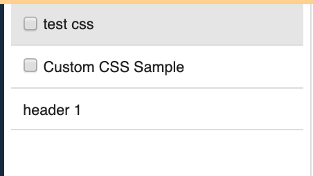

I’m at work, so would need to head home to make sure I understand what the original functionality is versus what you’re currently trying to do. I think i get it but need to physically check it.
I am having trouble replicating this. On my version in both “light” and “dark” the todo’s already get a strikethrough when you check them.
In case it changed in a different version, I am using Joplin 1.0.197 (prod, darwin) on Mac
Unchecked:
Unchecked
Checked:
Checked
Let me know if I misunderstood.
