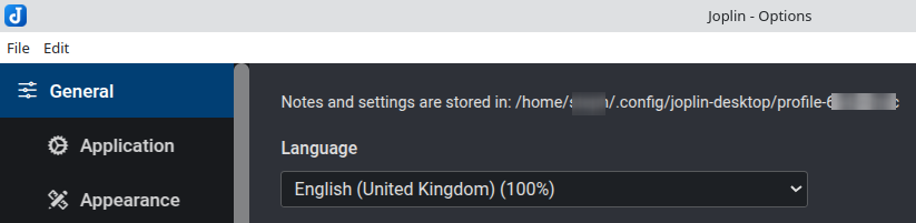

    Datas are there :
  7. I also put a link toward this AppImage on the autostart of Kubuntu (french version) in order to have it open at every start of the computer.
    The proof I use the last version:

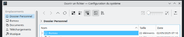

On the desktop:
