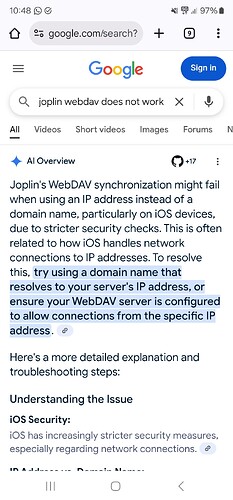

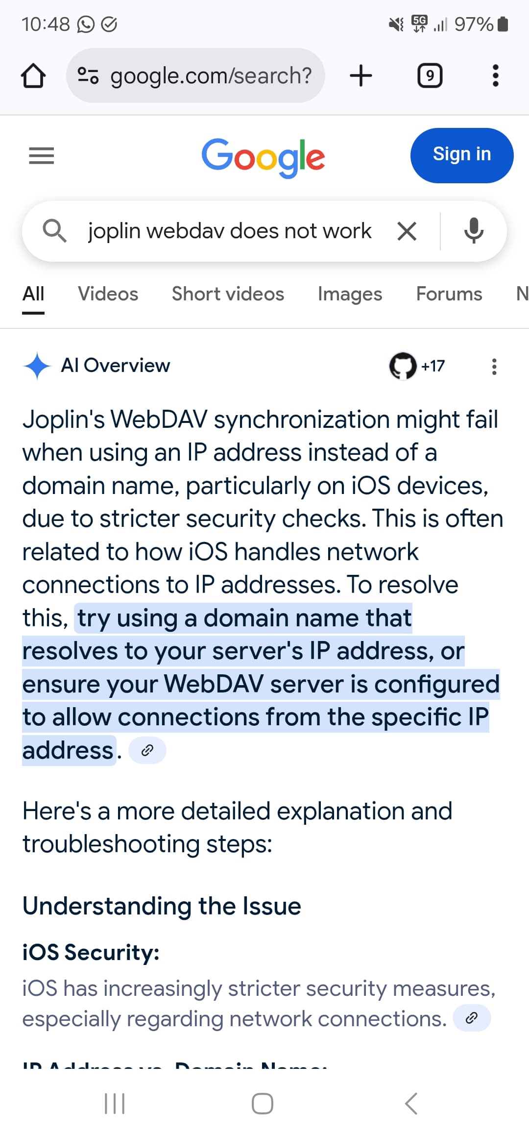

This is an AI response from Google asking "joplin webdav does not work ip address"
There may be similar security restrictions / policies on Android which prevents you using an ip address to connect to your server with Joplin
Both the IOS and Android app use React Native, so there may be restrictions with that:
