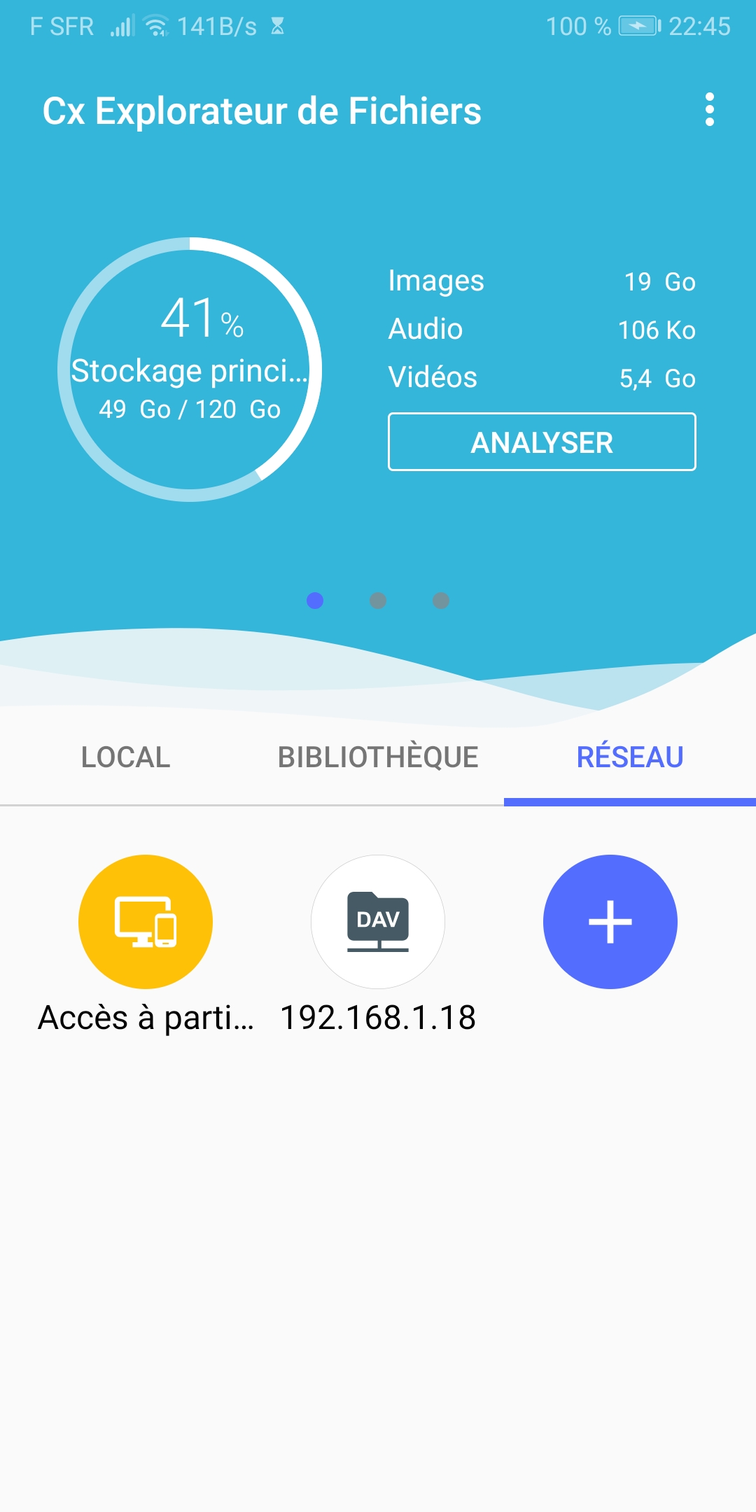

I try with another application on same mobile “Cx Explorateur de Fichier” Version 1.2.0. And it’s works …
I see an error , but nothing with tcpdump …
And it’s work with other and I see dialog with tcpdump :
