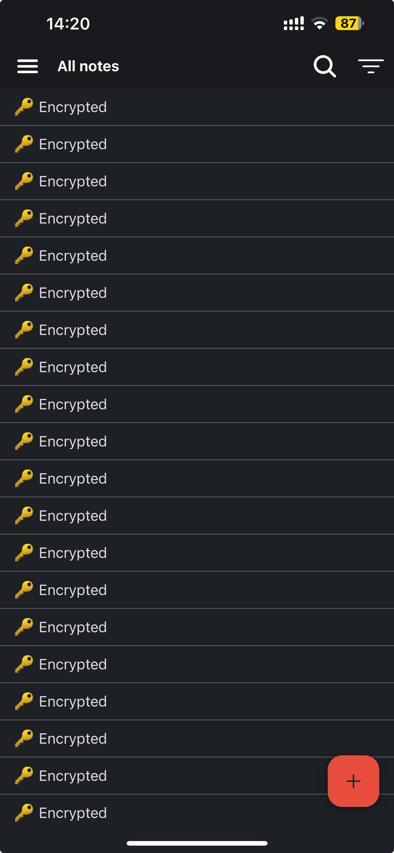

I'm finding it impossible to sync Joplin on my iPhone with Joplin Cloud. Even after leaving it open for hours and preventing sleep, the process never completes and I am left with thousands of encrypted notes (even though the encryption config shows everything is set up correctly) and, eventually, Joplin stops working altogether (meaning that, after launching, the UI is unresponsive except for scrolling, even if I restart my phone). I've deleted Joplin several times and started from scratch, but this problem recurs.
Is there a solution for this? Thanks.

After a third reinstallation, the app appears to have completed a sync but there are still several hundred encrypted notes. "Decrypted items" has been stuck on 17/100 for the past 20 minutes. Here's the log: mobile-log.log (5.6 MB)
I do have Joplin on my iPad but I rarely use it, so haven't tried syncing it since last year. I feel like the iOS sync suddenly sprung back to life after I launched the iPad version. Could a stale sync state on the iPad have affected iOS syncing?

I don't know what did it but, suddenly, the decrypted items count started going up quickly and, after a couple of hours, it completed.
I can't offer a solution as such, other than to make sure all your other devices are synced and to have patience.
