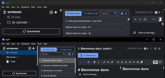

From this one I copied the external link of a note.
On Wiindows I created a shortcut with this link.
But... When I click on it a new instance of Joplin 3.3.3 completly empty is starting with no trace of the note linked !!!
Don't worry : the normal NOT empty instance is still there...

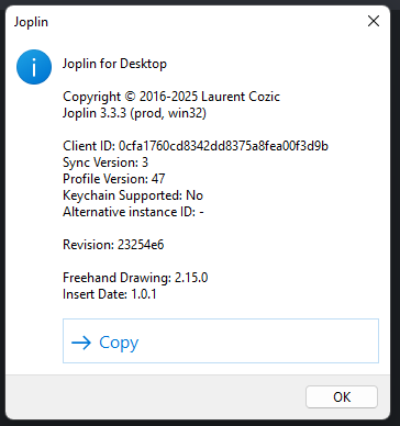

Follow your "DOG food" link to open up the "empty" version of Joplin and click Help > About Joplin. This will show the version. Also only an installed version will be listed in Windows under Settings > Apps > Installed Apps.

For example the linked note is there:
See (already mentionned above):

See screen capture some posts above. It's 3.3.3 that I have never installed in a desktop version !
No. That screen capture is from when you opened Joplin by clicking the JoplinPortable.exe file to show that in Help > About, Joplin Portable was also named Joplin for Desktop.
You can tell it is from a portable instance as:
  1. There is no keychain support and
  2. There is not a default Backup plugin included
What I was asking was to start Joplin using your "DOG Food" link and display the Help > About for that "empty" copy of Joplin.
This screen capture is from the "Dog Food" not from JoplinPortable. That's why I put it there ! A mystery...
