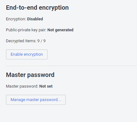

I'm not able to replicate this. Is there any error in the console when you click on the button? How to enable debugging | Joplin
  • Win10 22H2 (Virtual Machine)
  • Joplin 2.10.4 Desktop ("installed for me")
  • Flags.txt set
  • File system sync
  • Default install, no plugins. no modifications, no notes added
  • Default notes synced
  • Settings encryption selected
  • Enable encryption button changes colour as it registers click but nothing happens
  • Log attached
log.txt (32.7 KB)
Encryption_Button
Same happens if the master password is set before trying to start the encryption wizard.

@laurent would it help if the above post was created as a GitHub issue?
Thank you for creating the detailed report, and yes it would be better on GitHub, so that we don't forget about it
In v2.10.6 (pre-release) this looks fixed i.e. clicking on "Enable encryption" does trigger encryption actions.
How to encrypt, setup of Master keys, etc. is out of scope here, so for me this issue has been solved.
