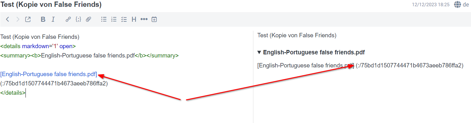

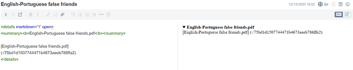

I changed the code (which was inserted like this by Joplin) according to your example. The result is not convincing, not even on the PC:
It looks like you're using an HTML note (not a markdown note).
HTML notes are not as well supported by Joplin as markdown notes. Try creating a new note (with the "new note" button) and pasting the markdown from this note into the new one.
What did you use to get Joplin to add the folding text for you?
Copying dpoulton's code into a new note does not change anything, sorry:
It looks like there is a space character between .pdf] and (:/75bd. If so remove it.
There was a line break but no blank. I removed the line break; the only thing that changed was that now there is a pdf icon before the address. I still cannot read the pdf on the mobile.
