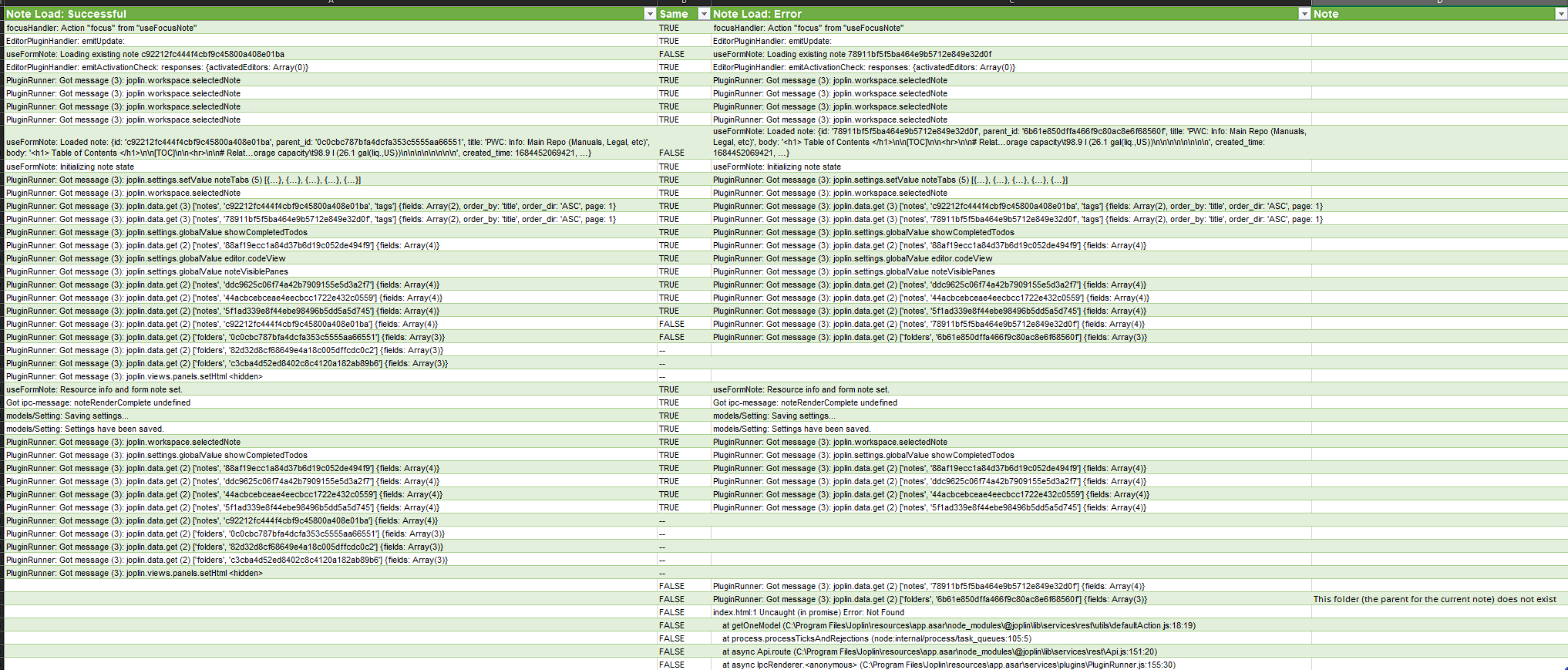

In my ongoing attempts to resolve the above duplicate note issue, I created a comparison of a valid Note load and a Note load of the duplicate Note - which throws an error in the dev-tools (console, debug mode).
The duplicate (zombie) notes all appear to have a parent_id that does not resolve.
Is there a reasonable way to search the Joplin database, via either Joplin, the Joplin API, or a SQLite tool (DB4S) and remove any notes that have a parent_id that does not resolve to a viable parent?
Link to data: Joplin Debug Log - Google Sheets
