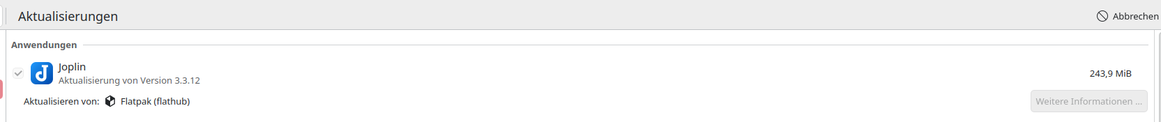

What could it mean that I have already received ‘Update from version 3.3.12’ twice (2025-07-10 and 2025-11-19) and that ‘Joplin 3.3.12 (prod, linux)’ is displayed both before and after the update – i.e. no change is visible. On my Windows computers, I have Joplin 3.4.12 (prod, win32).
3.4.12 is the latest prod version. 3.5.6 latest beta version
Are you using Flatpak? I ask as looking at the Flatpak repo for Joplin it still only provides 3.3.12.
The Flatpak version is not an official version published by Joplin so it is up to whoever maintains that package to update it on FlatHub.
(EDIT: It looks like they are trying but the builds have failed.)

Yes, it actually looks as if the Tuxedo OS repository only offers a Joplin Flatpak via their ‘Discover’ programme management.
If that's not the officially supported version, I don't want it.
Of course, I only want an officially supported version.

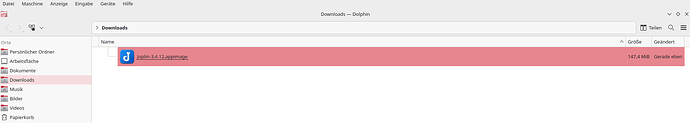

Using the ‘Check for updates’ function in the Flatpak - Joplin version 3.3.12 installed on my computer, I received a file
Joplin-3.4.12.appimage (147.4 MiB (154,561,716)).
Am I correct in assuming that this is the current official version?
The question is how I can get from where I am now to an officially supported installation.
I think I should first completely uninstall the Joplin Flatpak using the OS’ uninstall function.
But what should I do after that? I have no idea what an ‘appimage’ file is.
I suppose I could run it with a double click – but is that a good idea? I suspect not.
