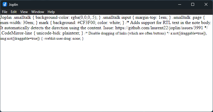

The regular UI does not load after installing 3.0.14. See screenshot for bare frame that does load.

Any custom css then? This is a very strange bug.
Could you see if there's any error in the console? Joplinapp.org/debugging
No. No custom CSS. I'm using a plain vanilla installation of Joplin.
Should have mentioned that the menus are not complete and that I need to use Window's Task Manager to kill the Joplin app. There are 4 or 5 Joplin processes running. Hopefully that is normal?
Here is an example of the abbreviated menus:
Workaround: After killing the Joplin processes, I can start the Joplin app successfully.
After several experiments, it seems that the stripped-down UI mainly happens when starting Joplin after a reboot.
