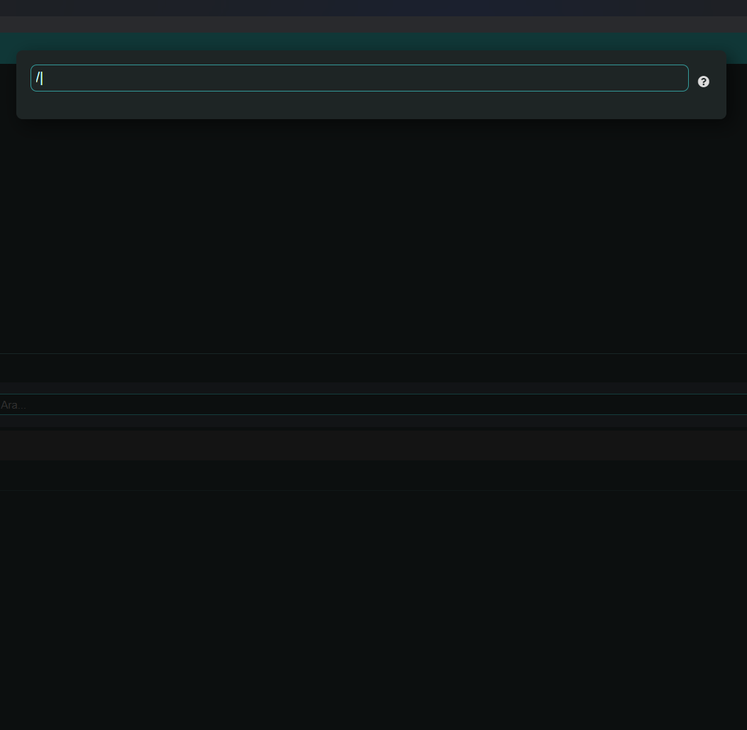

Thank you very much for your feedback. So, we confirm that the / symbol doesn't work exactly for special characters. I also tried searching with /|, but no results came up. I will attach a screenshot. Did I do it correctly?
No, basic search with / works for special characters. It works in the search bar, but not in Goto Anything. This is why your screenshot shows no results.
