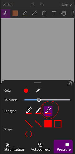

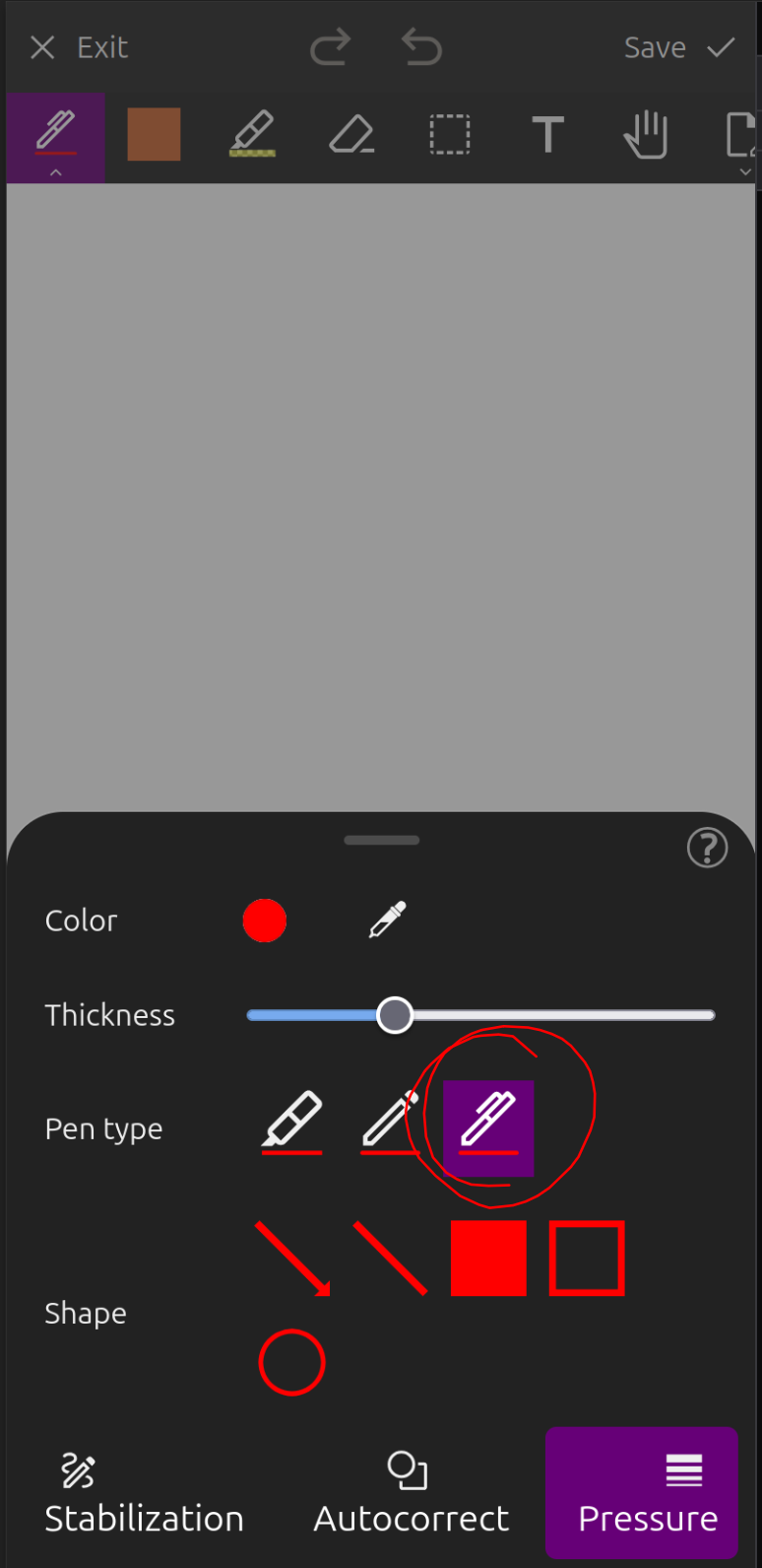

Here two settings that might help:
Additional notes: Joplin's inking functionality currently runs in a WebView. This simplifies cross-platform development but introduces a few limitations. For example, the eraser button doesn't work on some tablets (see this Chromium bug report) and there may be higher latency.
I cannot judge whether it is a matter of lag of development resources - I'm not a developer. There are many features in Joplin much better like in Samsung notes, so apparently it is not always a matter of money. Many thanks for your input guys. The recommended settings indeed mitigate the issue slightly, however apparently it is not made to write longer text. Also when my hand is touching the panel during writing I always accidentally draw lines on the panel. Don't get me wrong - Joplin is an excellent tool and will use it anyway. :slightly_smiling_face:
