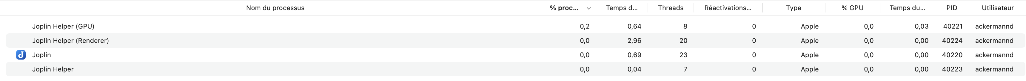

I don't know which plist file you are talking about, but when checking in Joplin.app/Content/Info.plist I do not find any LSRequiresNativeExecution key.
As I found they are mutlitple plist files in the application directory, I used a grep command and found nothing. (command I used : grep -R -i LSRequiresNativeExecution *)
Moreover, in the Activity monitor when I check for type it says "Apple" on every process as you can see here :
Tell me if you need any complementary information.

  1. I downloaded the prebuilt Apple Silicon binary from github .com/noah-nash/joplin-arm64-darwin-guide/releases. (Notes from the person who kindly created that binary and documented the process are in this blog post: noahnash .net/blog/joplin-apple-silicon/ .) Note: the system is not allowing me to include links, so you'll need to remove an extraneous space from each of those links.
  2. In terminal I ran the following command:
    xattr -d com.apple.quarantine /Applications/Joplin.app
    (Without this step, the application could not be launched because it was unsigned and produced an error stating that the the application was "damaged.")
  3. I then launched Joplin with no problems. (I believe the very first time I launched the application I control-clicked Joplin and selected "open" from the resulting contextual menu.)
Thank you!
I followed these instructions and am running arm64 Joplin on an M1 Max computer with webdav sync. It is much more responsive than the emulated official x86 build. I especially notice that there is no longer a delay when switching between notebooks, something that had bothered me before. I didn't need to re-setup the program at all; all settings were retained.
I would encourage other apple arm64 users to try this. I hope it becomes an official build eventually.
