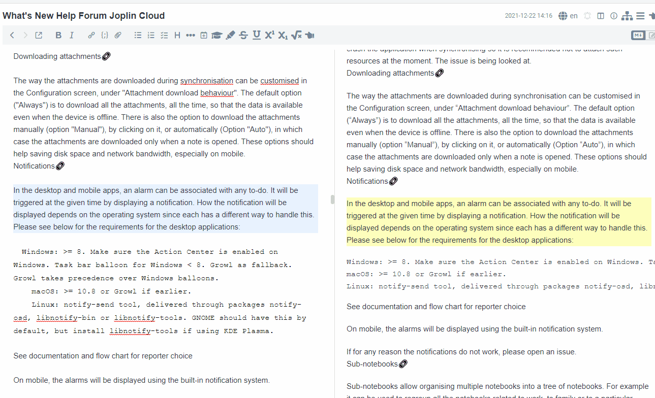

@CalebJohn The editor is still jumping around for me when I have "Render images below their markdown source" enabled. Whenever I scroll to a location, a second or so later the location will jump a bit which is pretty disruptive.
Can you double check that you have v0.8.1 installed and have restarted the editor since? If that checks out, can you maybe send a video?
v0.8.1 removed the plugins ability to do any scrolling, so if you're still experiencing this then it's likely a bug that will need to be fixed in the core app.
I've confirmed that I have v0.8.1 installed and have restarted the editor. I've tried this on both Linux and Windows and whenever that option is enabled, I see it happening:
inline_image_jump
Thanks for sharing the video, that's definitely annoying. This is different from the bug caused by this plugin, it only happened when the editor was open alone (no viewer).
My first thought would be that maybe this is caused by the "Better Markdown Viewer" plugin because it has some ability to scroll. But I can't duplicate your issue even with it installed.
Could you try disabling all plugins except for Rich markdown? I'm wondering if it's possible that this is a bad interaction between multiple plugins.
The problem still persists after disabling all plugins except for rich markdown. It happens both on split view and editor view. Have you tried it on a very long document with a bunch of pictures?
