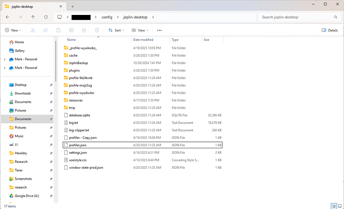

I created a new profile, let's call it "NEW". I exported a notebook from the default profile using JEX format and imported it to the new profile. Once I was sure the new profile was right, I deleted that notebook from the default profile. I can see each profile's folder in /.config/joplin-desktop.

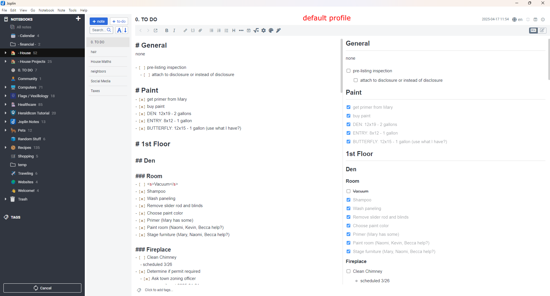

Everything was working fine then I realized I had not set up the sync for the new profile. So, I chose OneDrive, which is the same as the default profile. Then the system synced and the "NEW" profile contains ALL notebooks from each profile. The default profile contains all of the notebooks it had before, but does not include the notebook I added to the new profile. I'm now afraid to do anything because I don't know if they are somehow connected or what's going on.
