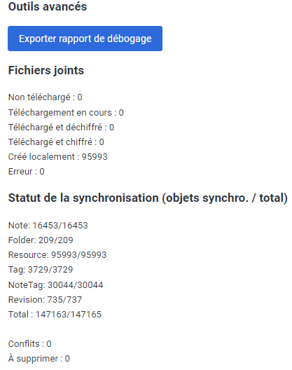

It can be any of the objects under Help => Sync status
It can be ignored
I exported and opened the csv report, I have more than 54000 lines like these:image
I don't really know what that means but I'm happy to see nothing in the column "is conflict" :laughing:

I just made an important discovery:
When @laurent told me about this place, I just saw the debug export button there, and nothing below:
I just consulted the exported csv and its 54000 lines, and that's why I said that it didn't help me too much :sweat_smile:
But I went back, and without paying attention, I stayed there a little longer, and bam, after about 25 seconds, magic, a whole bunch of clear information was displayed :open_mouth::
Note: 16453/16453
Folder: 209/209
Resource: 95993/95993
Tag: 3729/3729
NoteTag: 13211/30044
Revision: 0/735
Total : 129595/147163
Conflits : 0
Ă€ supprimer : 0
This information is of great help to me because I see what is happening, and unless I am mistaken, and despite what Joplin has told me several times, the synchronization is not complete and still in progress!
As the day progressed I was able to observe the evolution :slight_smile: . This morning the resources were not finished, and now NoteTags are in progress.
By the way, I wonder what these NoteTags are :thinking:
In short, this seems like good news to me: the sync was just not finished, I will continue to be patient :slight_smile:

The sync finally ended...
... Well, this is what I was hoping for: I then pressed Synchronize, telling myself that this time it would finish in a few seconds, but now I have this:
What are these downloads?
Thanks :slight_smile:
