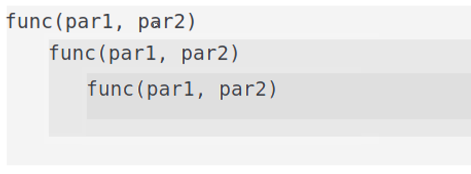

Hi, I decided to use Joplin to make my college's coursework, and it was a good choice until I had recursion classes, I miss a feature (or I found a bug).
I made this to put a Markdown code block inside this code block, but the output is:
(next post)
Is there any way to make what I was intending ?
Thanks and sorry about my English.

Sorry, I was not clearly enough
This was my expected output:
This is what I was calling "block inside a block"
