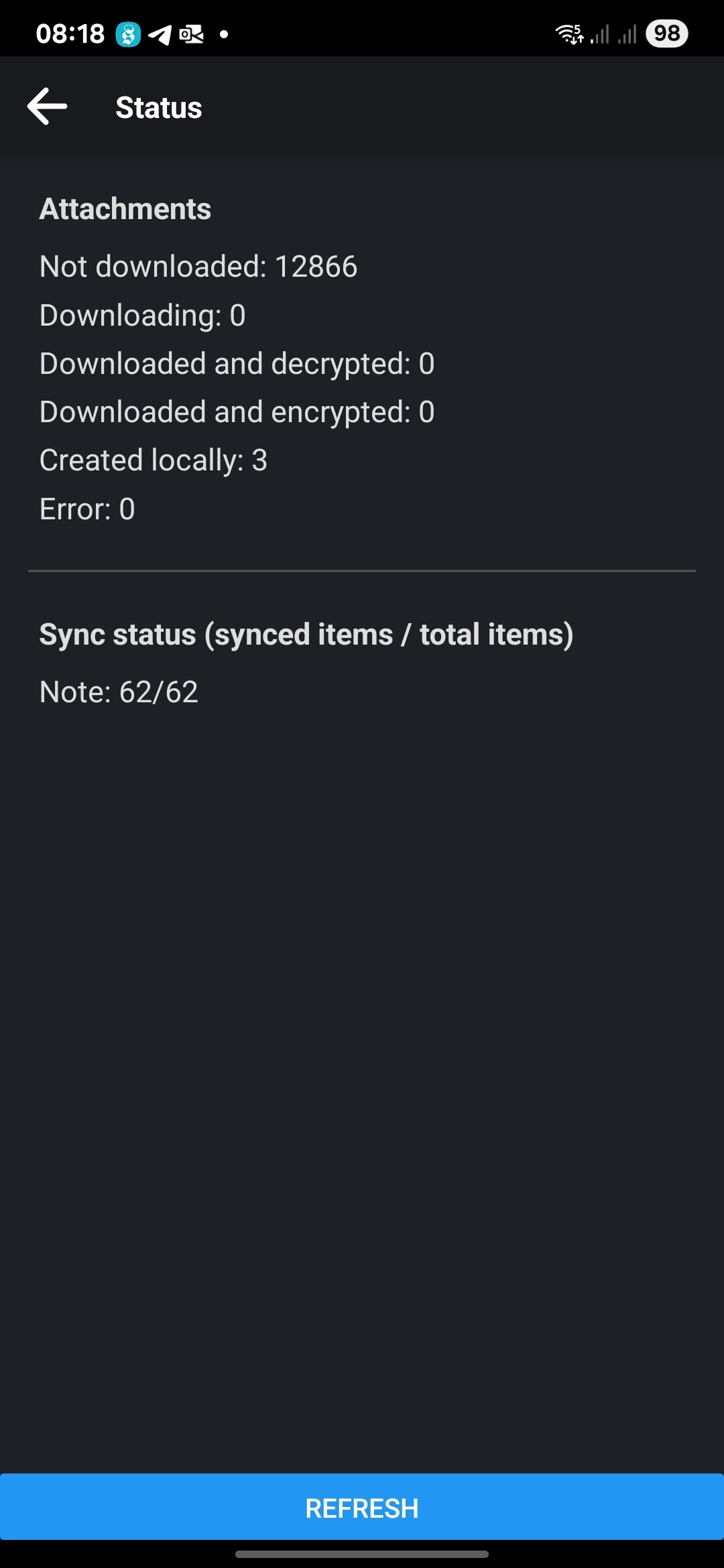

Thanks I follow your suggestion. Unfortunately it's almost a week and even in I, try to reinstall the app my status is, like this

The sync seems finished but I see this. And after 5min it start again.

Your status screens above seem to show that everything is synced actually.

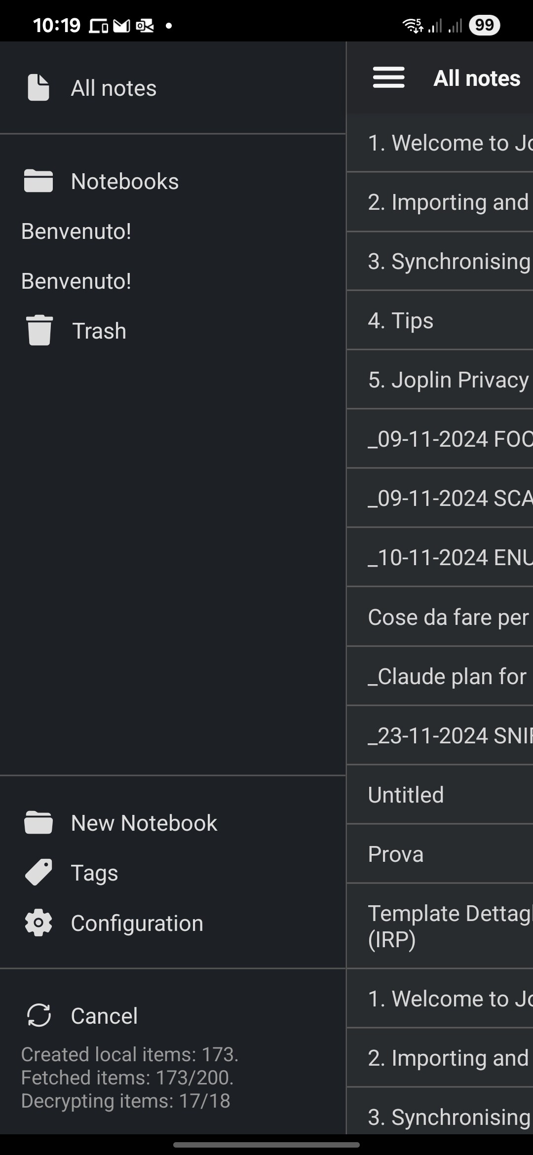

Could you please post the screenshot of the left sidebar, where it shows the synchronisation progress?
Exactly It seems that everything is working fine but I see only 62 notes no notebook ;nothing.

I mean at the bottom of the sidebar, it shows the sync process - this is what we'd need to see.

This is, what my android looks like.
Stai in sync forever it's more than a week by now.
