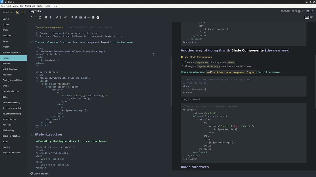

I've modified my theme a little bit so now I have responsive columns for the markdown render and 2-column grayscale layout for pdf exports.
Hope someone will find this theme usefull :slight_smile:
Demo video :
You can download it here if you want

And yes, I agree with you about the table title color, I will update it in the next version.
Can you show me the exact position of the approved icon? I'm not so sure.
It''s an H1 heading. In the mark up editor it looks like this in the viewer the icons are colored
