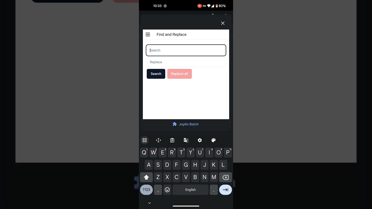

Release 0.2.0, Compatible with mobile devices.
Download link: Release joplin-batch@0.2.0 · rxliuli/joplin-utils · GitHub
