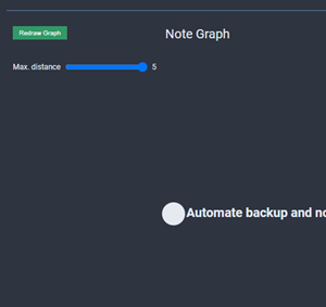

@GabrielMPhi Next plugin version will include settings, which can be changed directly in the graph user interface. The first one will be a slider to set maximal note distance.
I guess we can later also do this for your mentioned notebook-filter. So you don't have to go in to settings menu and rather adjust directly on-the-fly in graph.
More on this shortly!
Changes v1.5.0
Graph interface has "Max. distance" inline setting:

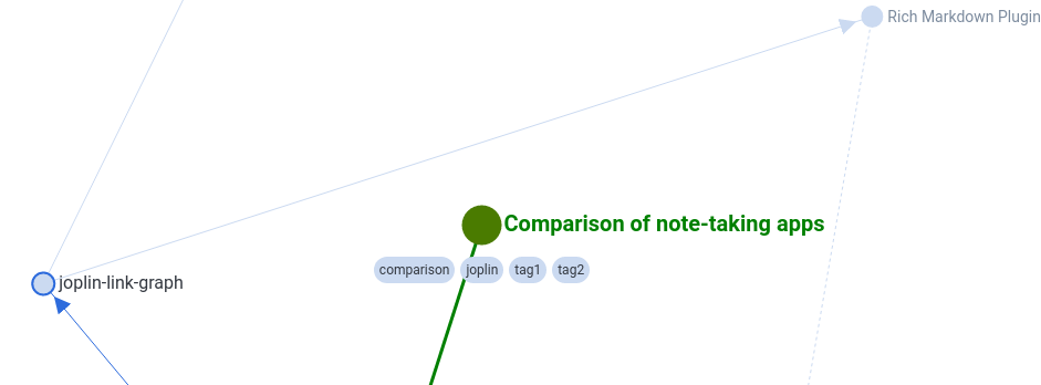

Show Note tags when hovering over a node:
