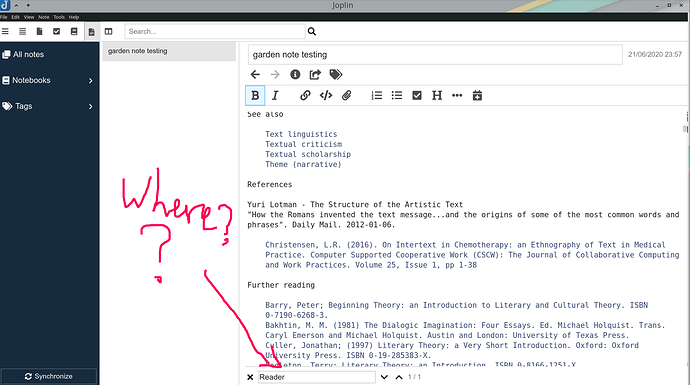

it does not work here…
i saw the word “Reader” in the note somewhere before… i am sure of it.
then i used “CTRL+G” to do a global search and confirmed it is in this note.
i clicked the result to go to the note. and then i do a “local note search” (CTRL+F), but i can’t find where on earth is the word “Reader” …
it doesn’t work for me. no highlight. i browsed thru the note, but ican’t find the word “Reader”, even after Ctrl+F.

CTRL-F will highlight the word in the rendered document. Not in the editor. You are looking at the editor. Is this ideal? No. Are folks working on a means to add search to the editor as well? Yes. But right now … that’s how it works. If you click the layout button and unhide the rendered document, the word you are searching for will be highlighted … assuming it is there.

Ctrl-G is not a search, it’s the goto-file command, this is why you’re not seeing word highlights.
F6 and Ctrl-F. The current Joplin editor component does not easily support highlighting of words Luckily a new editor is being worked on that will replace it and highlight words in the editor and the rendered view see this pull request. For now you need to have patience.
