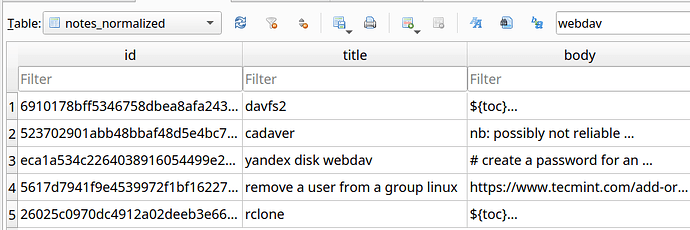

i opened the corrupted database (i saved it)
if i query the 'notes' table it finds the missing note:
if i query the 'notes_normalized' table it doesn't find the missing note:
so, the problem is possibly with this table 'notes_normalized', it needs to be rebuilt
another question: i didn't find the index of title vs note_id (see the pic below). where is it? and how can these be rebuilt from scratch (sqlite command)?
UPDATE
i found out that the missing note with the id 'f3b902b4ff744679a3fa4be65f4b92af' is present in 'notes' table, and is NOT present in 'notes_normalized' table

i am not a database engineer, so, let me explain my problem in plain language:
  1. the note with the id 'f3b902b4ff744679a3fa4be65f4b92af' is MISSING in the table 'notes_normalized' of database.sqlite but is PRESENT in the table 'notes' of database.sqlite.
    this is a bug. how can it be fixed?
  2. what should i do to be able to find the note using Joplin GUI (without use of sqlitebrowser)?
    at present, Joplin doesn't work as expected: it doesn't find the note which does exist in the database (in the table 'notes' in database.sqlite as shown in the pic in the previous comment)
