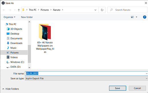

Issue -1: Is there a way in plugin development other than using joplin.interop export module to create a dialog box that can help users to choose the destination folder?
Something like a user clicks a button and that dialog appears.

Is was talking about this dialog :sweat_smile: use to browse the local file system.Is this type of dialog can be created with HTML/js.

And @roman_r_m :sweat_smile: about this dialog

  1. Here first thing I am taking absolute path as an input here.I want to know if it is possible that rather than the user typing himself the whole path user can specify the path just by browsing [ using the dialog that I have uploaded above ]. As much as I have read the plugin API doc it is only possible using that joplin.interop export module. I tried installing electron as a dependency to my plugin so that I can create a dialog myself but electron didn't work as a dependency.

  1. It's not currently possible but I suppose we could try to expose these APIs.

Plugin api is very well planned and provide various kinds of end point[methods] to construct almost every type of plugin developer want. But during my journey of building a plugin from past few days I observed that in plugin api's some method are a lot more particular toward a certain job. No doubt it make easy and fast workflow for the plugin development but it also kills the flexibilty to do various kind of job.Like this dialog for browsing local file system can be constructed with dialog.showSaveDialog but under plugin api it is only exposed if we are using export module.As a keen gsocer I would like to work in this field under guidance of mentors.
