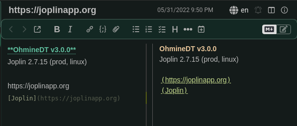

Is it just me or are links not properly rendered starting with Ohmine DT v3.0.0?
Note the parentheses around the links. Links are fine on Ohmine DT v2.2.16.
I'm using the latest Joplin App 2.7.15 with no plugin installed.
Hi @PeekPoke
This is the default behavior of the theme. If you do not want parentheses around links you must modify the file userstyle.css
and pass the option "none" (instead of "inline") on to the next line (48).
--switcher-link-bracket-display: inline; /* ON: "inline;" | OFF: "none;" | turn on/off the effect of automatically adding the monospace bracket to links */
Then restart Joplin.
I also find that parentheses should not be the default behavior but it depends on the uses. In any case, we can modify.
Hi @PeekPoke, as @bepolymathe said, this is just a link decoration, you can turn it off by editing the switcher within the userstyle.css
. Line 48 of OhmineDT v3.1.75
change to:
--switcher-link-bracket-display: none;
Anyway, I think I will set default to turn it off in the later version. Thank you for supporting OhmineDT!
