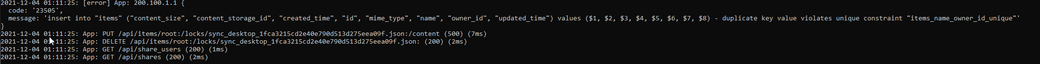

I was able to upgrade and everything worked fine, and then my syncing stopped working about 2-3 days later
Any ideas?

The log you attached doesn't include the error from your screenshot.
Hm, when I run docker logs --follow it shows the error, although a docker logs -- follow > log.txt does not, How can I obtain this for you?
The log.txt you just mentioned should work, or maybe copy and paste the text from your terminal, provided it's all on the same screen.
