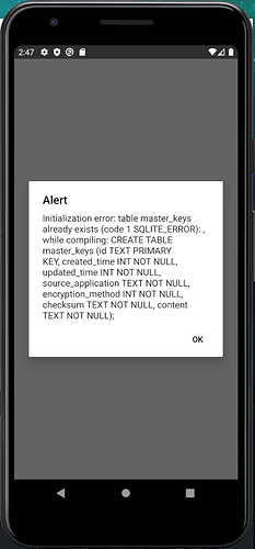

Occasionally this error pops up on the Android emulator:
Here’s the output from npm run start-android

I’ve done android development before but never react native so I’m struggling getting this thing passed this loop with no error.
Appreciate the help.
This is due to React Native Live Reload feature, which they enable by default even though it’s broken. I had tried to disable it in code but it doesn’t look like it’s working, so you’ll need to open the debug menu Ctrl+M and disable Live Reload. Then close the app completely and reload.
I wanted to follow up and say the only way I can get out of these loops is by background the app while the database stuff sets up, then foregrounding the app once that is all done. It’s quite weird.
