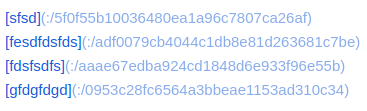

it should be
[A](:/409ad50cs6f4e82afa8ec141e7277)
[B](:/7b29b47d9b374b0giyubgja60a9264d)
[C](:/d7c8c7354c4ed54gdgfd55c528db31)
